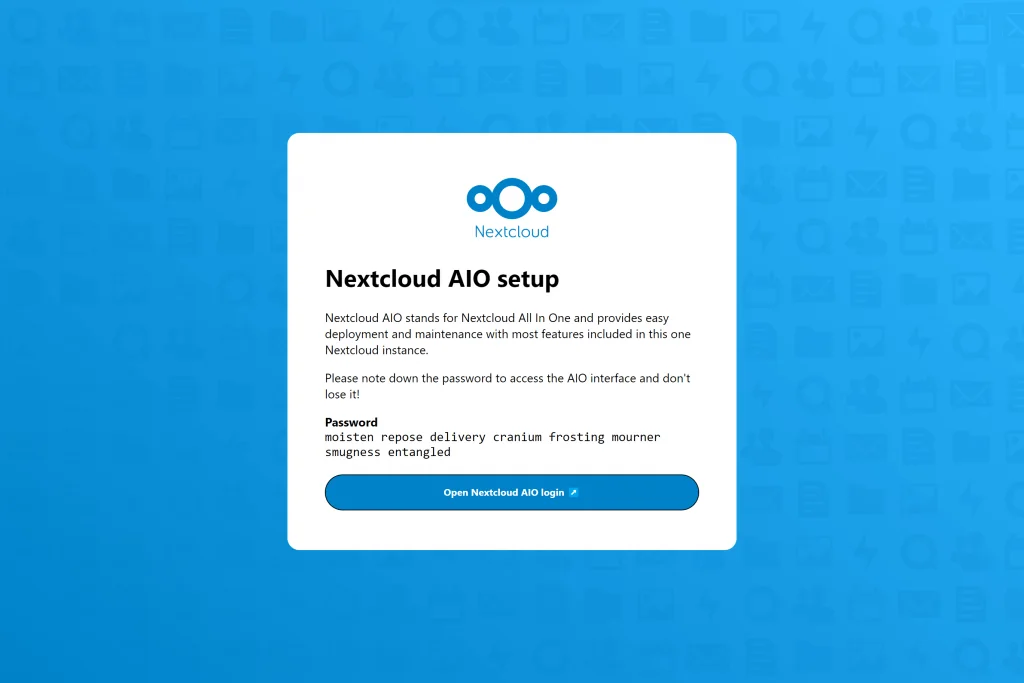

Accept the self-signed certificate, then you should see this:
4. Click on “Open Nextcloud AIO login” and enter your password.
