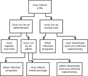

A simple approach to threat modelling is asking yourself: “what do I want to protect myself from?” Think of an imaginary attacker and think what they could do to breach your security. Then find solutions for the approaches you found. A formalized version of this approach is using ‘attack trees’ which was invented by security expert Bruce Schneider. You see an example attack tree for a virus attack here:

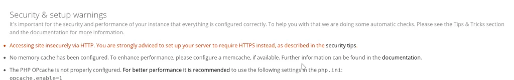

Transfer encryption used by Nextcloud secures the connections between servers and clients. This uses standard TLS, a secure communication protocol used by HTTPS. HTTPS is what makes the lock in your browser address bar turn green! It is configured in the webserver, like Apache or NGINX, and our manual contains some instructions here. We strongly recommend to always use Nextcloud with TLS and we’ll warn system administrators strongly if it is not turned on.
Nextcloud warns the system administrator if HTTPS is not enabled

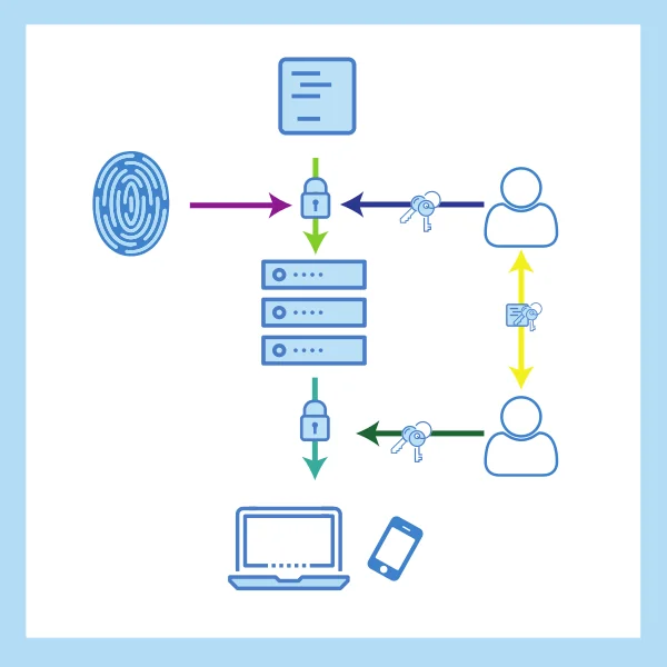

Client side end-to-end encryption
The ultimate protection of user data is provided by end-to-end Encryption. The Nextcloud end-to-end encryption feature is designed such that the server never has access to unencrypted files or keys, nor does server-provided code ever handle unencrypted data which could provide avenues for compromise.
Nextcloud makes end-to-end encryption very easy to use, seamlessly handling key exchange by the server without leaking any data and facilitating easy sharing with other users and collaboration. However, it comes with a feature loss as any type of online file editing and access to encrypted data as well as public sharing and sharing to groups is not possible for data in folders that are end-to-end encrypted.
Users can activate the Nextcloud end-to-end encryption feature for one or more folders. The content of each of these folders will be fully hidden from the server, including file names and directory structure. To sync the data with other devices, users have to enter a code created by the first device. Once that is done, end-to-end encrypted folders are seamlessly synced between devices. Users can share encrypted folders with other users on their server without any need for re-encrypting and re-uploading the data or having to enter passwords for either sender or recipient.
